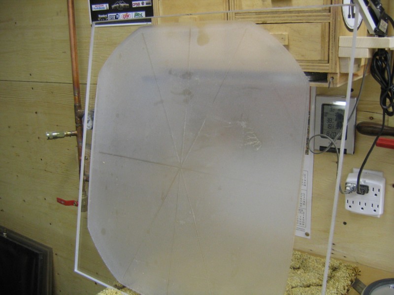

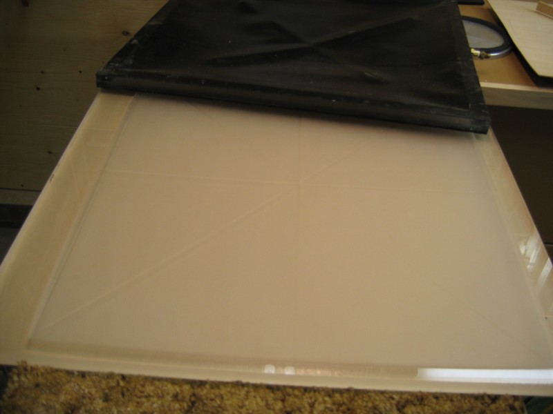

This is a picture of the dish with the lid sitting beside it. These dishes are about 24 inches square on the outside and are cnc milled from 3/4 inch acrylic. The lid in this picture is a glued together frame but we think that for the production models we will mill the lid from one piece of acrylic and will use the piece left from the middle to make bridge clamps.

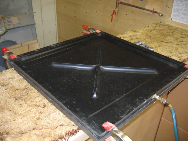

Here is the system under vacuum with a test piece on my bench. For now we have black rubber but may change the colour if we can find what we are looking for for the right price.

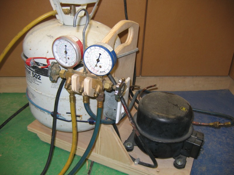

This is a picture of my vacuum pump. Just so you know that you don't require an expensive or elaborate pump system to run these things, this one is built from an old refrigerator compressor and a 20 pound reservoir tank.

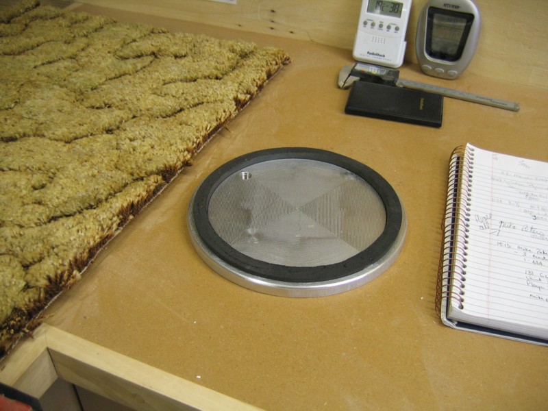

This is the start of my guitar holder. I will be designing a base for it that will be a wood/aluminum composite. We will probably make an all aluminum version very soon but still just offer just the dish so that you can make a fixture that best suits your working environment.

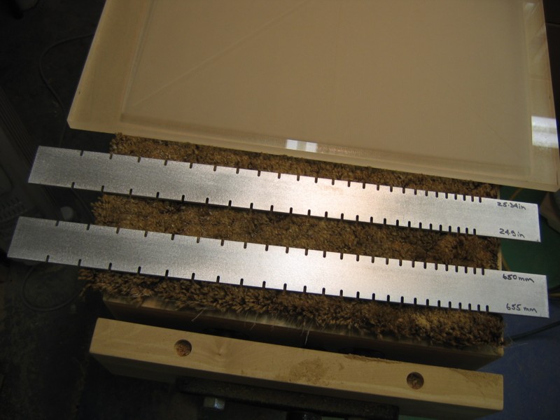

On the "percision tools" side of things we will also be offering fret scales made from 1/8 aluminum flatbar. Here are two that I had made for my guitars.

The fret scales are $36 USD each and will come with a pin that can be installed into your fretting fixture. The slot width is .125 inches.

The first is a picture of the outline that is formed when the dish is milled. This is a 15 foot radius.

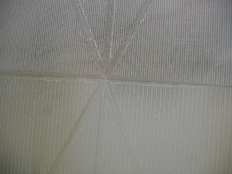

This is a close up of the milling pattern that allows for great vacuum. These grooves are quite shallow but are deep enough to allow the vacuum to distribute evenly throughout the dish.

Are your fret scales similar to Stew Mac's notched straightedge so they
could be used for checking the flatness of a fretboard?
If so, this is a tool I'd like to have in my stable.

Hey Chris, I guess it could certainly be used for that purpose. These scales are made from 1/8 by 2 flat bar aluminum so the edges are not machined. If I wanted to use it as you have described I would lay a piece of sandpaper from my thickness sander on a nice flat surface, like my tablesaw, and sand the edge, using the saw fence to keep the edge square. I would then check progress with my straight edge. Alternantvely we could probably machine the edges but that would cost more. But as Tony says.....nothing is impossible.....
